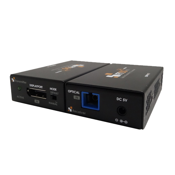

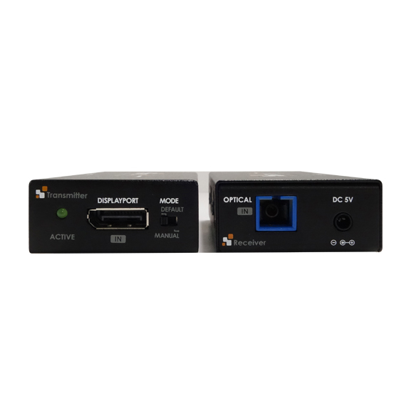

This unique fiber optical transceiver let your PC, digital HDTV or Projector extend up to
200 meter(656ft) away from host based on DisplayPort standard without signal
degradation by UHD (3840x2160 or 4096x2160 @60Hz) resolution.
▪ Compatible with DisplayPort standard V1.2
▪ Main-link video signal / AUX data and Hot Plug Detection signal is transmitted by- 1 channel multimode optical fiber
▪ Mode switch use(TX, RX)
▪ DPCP or HDCP compliant
• Input and Output Signal : DISPLAYPORT 1.2a Standard
• Video Bandwidth : 21.6Gbps
• Optical Connector : SC Connector
• Electrical Connector : DisplayPort 20 Pin Connector (Female)
• Applied Fiber : OM3 or OM4 Multi-mode glass-fiber.
• Maximum Supporting Resolution : UHD(3840x2160 / 4096x2160@60Hz)
• Transmission distance : 200 meter (656 ft)
• Power Consumption (transmitter) : 1.75W (Typ)
• Power Consumption (receiver) : 2.0W (Typ)
• Power Adapter 2ea
• 1.8m displayport cable 2ea
