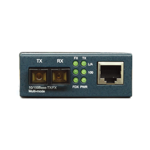

The OMC-110x supports on 10/100 Base-Tx port over CAT5 twisted pair cable and one 100 Based-Fx interface to connection with optical fiber module to apply in10/100 Base-Tx to 100Base-Fx converter application. It is compact, cost-effective, low dissipative, high reliable and stable.
• Complies with IEEE802.3 Standard
• Full and Half duplex with Auto-negotiation
• Supports MDI/MDI-X auto crossover
• Supports ond RJ-45 for 10/100Base-Tx connection and one SC connector for 100Base-Fx connection
• Table-top and wall-mount design for standalone type
• Diagnostic LEDs : PWR, FDX, LINK/ACT,10/100,COL
• Compact size
• Easy installation
• EMI & Safety : CE, FCC
• Standard : Support 10Base-T, 100Base-Tx, 100Base-Fx and IEEE802.3 spec.
• Interface ; SC connector using single mode or multi mode optiic fiber, RJ-45 connector using UTP 100-ohm Cat.5 Cable

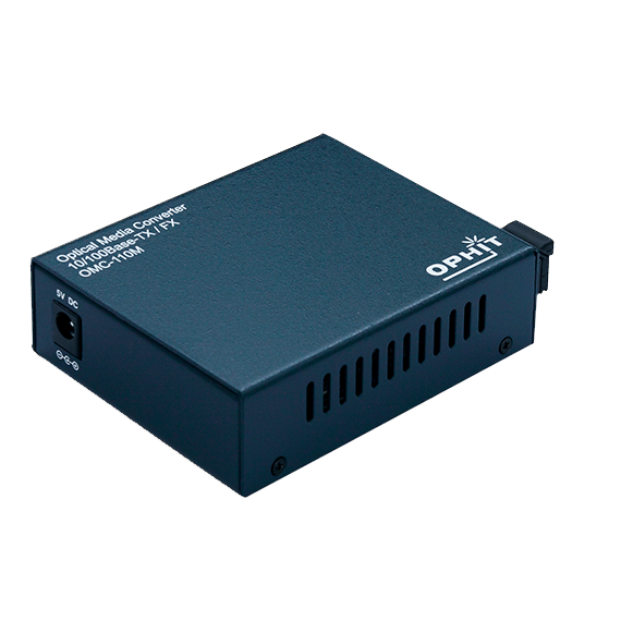

• Power Supply : 100~240V DC 12V
• Power Consumption : 3.5W (max)
• Dimensions : 94W x 70D x 26H (mm) / Weight : 230g
