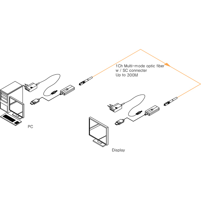

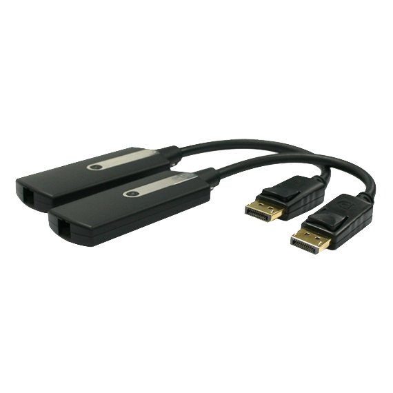

DisplayPort fiber optic 1ch pigtail module extender
DSFP, optical DisplayPort Pigtail module extender, is designed to let your display device extend up to 300 meters (1,000 feet) away from host based on Displayport standard by single strand optic fiber.
• High Speed and long distance transmission by optical system
• Compatible with DisplayPort standard v1.1a
• Maxinum supporting resolution 4K(3840x2160)@30Hz
• Main-link video signal / AUX data and Hot Plug Detection signal is transmitted by 1ch multi-mode fiber
