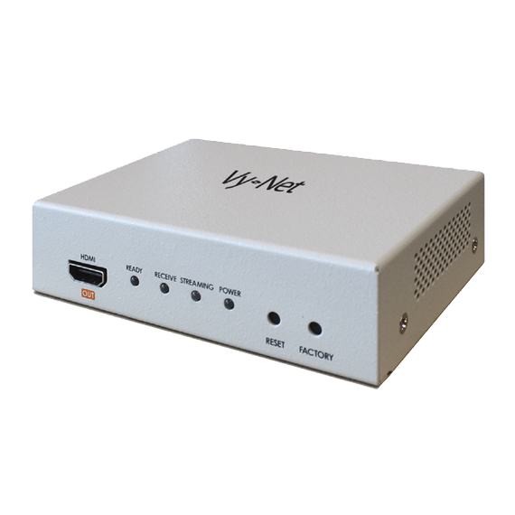

                Vy-Net is a Full-HD video over IP network solution that connects video sources to endpoint destinations. Vy-Net units can be configured as Encoder or Endpoint and can be used in a switching system (one Encoder to one, many or all End Points via Multicast) or as a simple streaming device (Encoder to PC software such as VLC via Unicast) or a combination of both. Vy-Net deploys quickly, integrates smoothly, can be updated remotely.
▪ Video Input / output : HDMI , Compliant with HDMI 1.3 Specification
▪ Network Interface: RJ-45, Ethernet 10/100/1000 Mbps, DHCP
▪ Streaming: - Performance: H.264 @ 1080P@60fps, - Protocols: Multicast, Unicast RTP, RTSP
▪ Support Power over Ethernet (PoE) 13W type 1 PD, IEEE802.3 at standard
▪ System Management: - WEB based GUI interface. REST Calls interface
- Confidence monitoring second stream (MJPEG encoding)

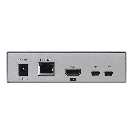

• Dimension : 120W x 80D x 31.2H (mm)
• Using electrical connector
- Input : HDMI A Type x 1
- Output: HDMI A Type x 1
- Ethernet: RJ-45 x 1
- USB: Mini B Type x 2
• Maximum Supporting Resolution : 1920x1080@60Hz
• External Power : 5V / 2A (2.1ø DC JACK)
• Power Consumption : 6.5W(Typ)
• Operating Temperature Range : +5°C~+35°C
• Storage Temperature Range : -20°C~+70°C
